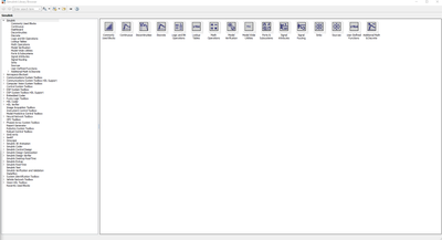

I meant that DSP Builder library is not displayed in Simulink Library Browser:

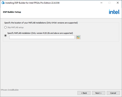

Is Matlab R2015a compatible with DSP Builder 22.4? Apparently it should be compatible according to DSP Builder Installing wizard.
After executing "DSP Builder - Start in MATLAB R2015a" (or "DSP Builder - Start in MATLAB R2022a") Matlab path is changed to "C:\intelFPGA_pro\22.4\quartus\dsp_builder". However, this directory is empty. All simulink files seem to be in "C:\intelFPGA_pro\22.4\quartus\dsbab". According to the thread https://community.intel.com/t5/FPGA-Intellectual-Property/DSP-Builder-Installation-Problem/m-p/69978, dsp_builder path should include BlockInfo.dll. Could this be the problem?
It is not compatible. For more info on system requirements please refer below link.
https://www.intel.com/content/www/us/en/docs/programmable/683697/19-3/system-requirements.html
Please install the compatible version.

I was aware of that information but I believed that table is outdated. There is no information about DSP Builder compatibility above v19.3. Is compatibility information for DSP Builder 22.4 available?
Please find the supported MATLAB version compatibility list with Quartus in the below link.
https://www.intel.com/content/www/us/en/docs/programmable/683322/22-4/system-requirements.html

Issue was solved using DSP Builder 17.1 and Matlab R2015a. DSP Bulder v22.4 and Matlab R2022a compatibility was not tested again. In addition installation wizard information is confusing because it specifies that DSP Builder 22.4 is compatible with Matlab R2013b or above.
