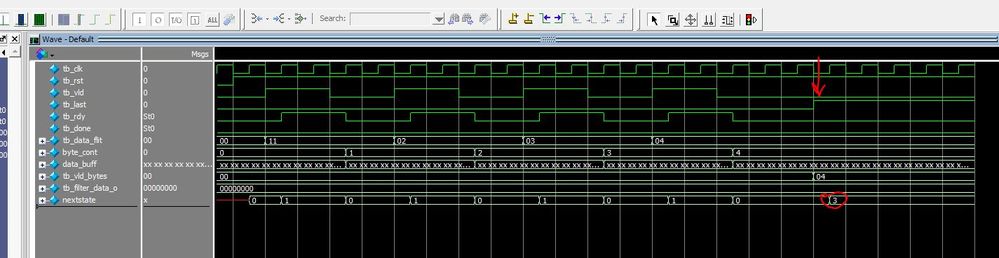

I am developing a fsm to latch on to incoming data and compute its average in verilog, but my fsm seems to be just stuck at one state.
Although the simulation shows it did shifted perfectly in previous states, but it is stuck at "filter_data_64" state . See complete code below :

You have nextstate in your case statement, but state never updates to nextstate.
Fix it by adding a sequential block to update state at every clock edge.
always @(posedge clk) begin
  if (~rst)
    state <= idle;
  else
    state <= nextstate;
end

Here is the simulation results
