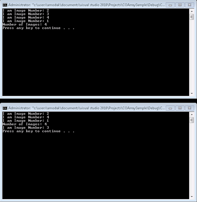

In the program below, I am using synchronization as well as flush. Even then I sometimes get (by doing repeated runs) the echo of individual image AFTER the total number of images. Am I missing something or this is a compiler problem?
Abhi
[fortran]      Program Sample_COArray
         Use, Intrinsic :: ISO_Fortran_Env
         Implicit None
         Integer :: J
  • Integer :: myImageNum Integer, Parameter :: MasterImage = 1 Write(OUTPUT_UNIT,"(A,I0)") "I am Image Number: ", THIS_IMAGE() Flush(OUTPUT_UNIT) SYNC ALL if (THIS_IMAGE() == MasterImage) then Write(OUTPUT_UNIT,"(A,I0)") "Number of Images: ", NUM_IMAGES() endif End Program Sample_COArray[/fortran]

    abhimodak
    2,996 Views
    Hi Steve
    Attached snapshot shows results of two runs.
    Abhi
    Steven_L_Intel1
    2,996 Views
    Well, I can't explain this, but also will comment that the Fortran standard doesn't specify the order in which things come out. It doesn't even require that the output streams be merged, though most implementations do so. Some strange timing thing, I guess.

    Steven_L_Intel1
    2,996 Views
    My opinion is that the behavior you want is not specified by the standard. The FLUSH simply tells the local image to flush its local buffers. What happens after that is unspecified. The order in which the merged output appears is unpredictable. SYNC ALL is properly synchronizing execution - it does not necessarily synchronize output.

    Michael_R_Intel4
    2,996 Views
    Steve is correct - the order of the output is unpredictable, and not defined by the standard.
