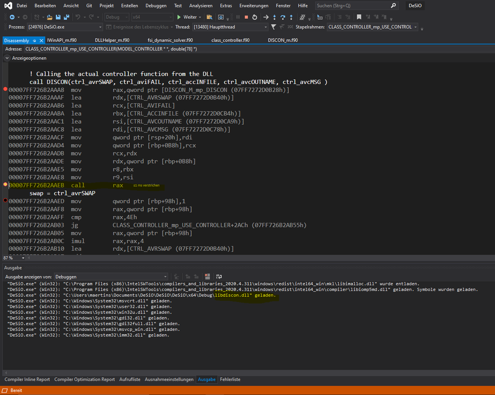

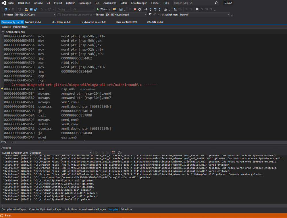

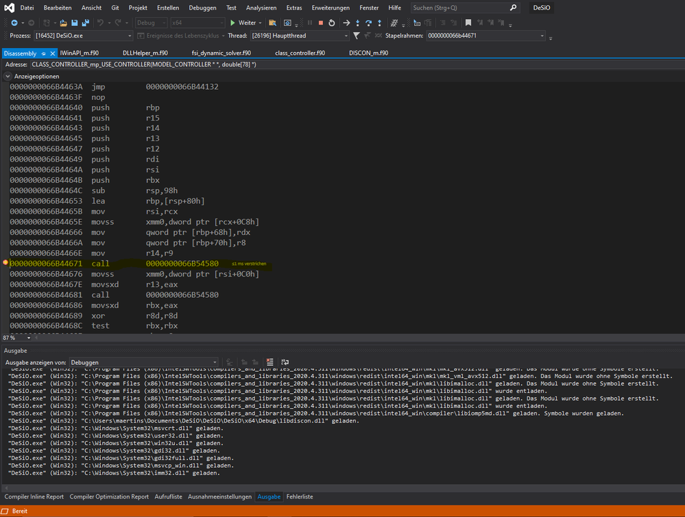

Thanks, you are right. I uncommented the parts again and adapted them to the DLL I currently want to use. I thought those code parts only work for DLLs that were generated from C++ code. There were kindly provided here: https://community.intel.com/t5/Intel-Fortran-Compiler/Integrate-C-DLL-in-Fortran-Code/m-p/1410919#M162620
Right now, I get the message that libdiscon.dll is loaded. Unfortunately, the code aborts when the subroutine DISCON(...) is actually called. I just want to make sure that the reason is not that the code expects a C++ DLL but gets a fortran DLL.
Steve_Lionel
3,400 Views
There's nothing language-specific about this part of the process. You say, "the code aborts", but don't say exactly what goes wrong (what error message, at what point it happens, etc.) When calling a routine in this fashion it is important that you pass the correct number/type of arguments that the called procedure expects. It is possible to debug a routine in a dynamically loaded DLL, but it requires some extra steps.
Dave12

jimdempseyatthecove
3,377 Views
When you build in Debug mode, have you stepped into the call the_model_controller%use_controller?
Does the error occur at the call DISCON?
If yes, then it is likely that the calling arguments are incorrect. In particular the contents of ctrl_avrSWAP. But check all arguments.
Jim Dempsey
Dave12
3,375 Views
Yes I did this. The error occurs when DISCON is called. I will check the input arguments again, thank you for the suggestion.

3,367 Views
To show you what happened I attach some screenshots.
The DLL libdiscon.dll is successfully loaded, as it can be seen in the first image (highlighted). Then in jumps into the assembly call instruction(?). I highlighted the step in image 1 and 2. In picture 3 I show what happens if I step in this call command.
So, considering the DLL is not damaged, the arguments are not correct?
Step 1Step 1Step 2Step 2Step 3Step 3
jimdempseyatthecove
3,365 Views
The call into DISCON succeeded (last screenshot)
What happens with the Step Out (this runs the code in DISCON through and including the ret)?
Jim Dempsey
Dave12
3,342 Views
If I Step Out at the point, that I showed in the last screenshot no error occurs.
I followed the procedure of Stepping In into the "call" commands and Stepping out after. This worked for some of the calls. In the following screenshots I show at which Step Out the programm aborts:
1122In the call depicted in the first screenshot are several further call commands. The one that aborts the programm is the one I show in the second screenshot. So Stepping In is possible, if I Step Out, the error occurs. I do not see any further error messages than those is the output window. Is it possible to determine the cause of the error based on the memory address or other information at this point?
jimdempseyatthecove
3,333 Views
>>...second screenshot. So Stepping In is possible, if I Step Out, the error occurs...
So you step in and repeat the steps 1:6
1) Note the source and line in the source code.
2) Issue Step Out
3) if no crash/abend goto step 1)
4) if crash, place break point at source and line of last Step Out
5) Issue Restart (and continue past call to DISCON)
6) Step through code to locate locality of error.
Note, while performing 6) you may find a CALL that fails. At this point, place a break on that CALL, Restart, at this break, Step In. Then perform steps 1:6 to refine the search. At some point you should have an ah-ha moment.
Note, this process is recursive in nature. You need to drill down call levels to the procedure that errors out.  Due to the error not being a Fortran reported error, this indicates it occurs in an external DLL. Check the arguments to see if they are trash. IOW either:
a) DISCON returned trash
b) An argument error on call to DISCON caused DISCON to "crater" (overwrite) code or other data.
c) DISCON closes a resource but the code following the call to DISCON assumes the resource is still available.
d) some other reason not apparent at this time
Jim Dempsey
