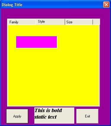

Thanks for your comments. I have found that the following will permit you to change
the text font on a static control:
1) add a static text box to the main dialog, giving it ID = IDC_MAINDLG_STATIC (for example).
Make it big enough to take 22pt text 'This is bold static text'
2) add this code to tabdialogglobals (add use DFWINTY if necessary to define type T_LOGFONT)
! font stuff
type (T_LOGFONT) lf
integer*4 hfont, hfontold
integer*4 alignText
integer*4 sizeFont
integer*4 directionText
integer*4 fontFamily
integer*4 fontWeight
logical*4 fontItalic
3) Add this initialization code to TabDialogSub in the dlg_init section
! Create a font for the static text. Store handle in global hfont
! font variables are stored in tabdialogglobals module
! destroy the font using DeleteObject when the dialog is destroyed
! create 22 point Times Roman italic font
sizeFont = 22
directionText = 0
fontWeight = 700
fontItalic = .true.
fontFamily = FF_ROMAN
lf%lfHeight = sizeFont
lf%lfWidth = 0
lf%lfEscapement = directionText
lf%lfOrientation = directionText
lf%lfWeight = fontWeight
lf%lfItalic = fontItalic
lf%lfUnderline = 0
lf%lfStrikeout = 0
lf%lfCharSet = 1
lf%lfOutPrecision = 0
lf%lfClipPrecision = 0
lf%lfQuality = 0
lf%lfPitchAndFamily = fontFamily
lf%lfFaceName = "Times New Roman"C
hfont = CreateFontIndirect(lf)
and this code to the dlg_destroy section
hfontold = DeleteObject(hfont)
4) Add this code to MainDlgSub
case(WM_CTLCOLORSTATIC)
! set the font for the static text inthe main dialog
if(GetDlgItem(hDlg,IDC_MAINDLG_STATIC).EQ.hwndcontrol) then
hfontOld = SelectObject(hDCcontrol, hfont)
endif
MainDlgProc=CallWindowProc(hprocdlg,hDlg, message, wParam, lParam)
5)Then every time the static control IDC_MAINDLG_STATIC is redrawn, the new fontwill beused for the text (see JPG attached)

I appreciate the help. I applied your code sections to your earlier triple-tab exemplar (BackColor) and was able to duplicate the result you showed in the jpeg. I even set the Font Code aside and called it as a subroutine (successful, btw, either from TabDialogSub OR from MainDlgSub).
On my side, though, the MainDlg I'm trying to adjust static text on is Modal (yours is Modeless). I think that's presenting a problem using your logic. (My font is not adjusting.) Any thoughts?
Also, is there a way to change the color, as well?
TC
p.s.
I sent a note to your private messaging box.
anthonyrichards
New Contributor III
2,660 Views
I changed my code from modeless to modal and still got the static text font to set ok.
What color are you referring to? The text, the Text box?
P.S. you can set the text font for the tabs by sending the tab control the WM_SETFONT message during
dialog initialization e.g.
lret=SendDlgItemMessage(hDlg,IDC_TAB,WM_SETFONT, hfont, MAKELPARAM(1, 0) )
