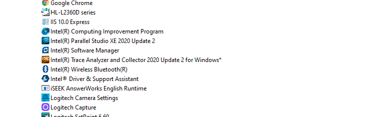

Thank you JohnNichols.  To uninstall, I am to use the Programs and Features Uninstall on Windows 10?  I ask because the only items under parallel studio are the updates.
JohnNichols
Valued Contributor III
3,957 Views
Capture.GIFTake out anything related to Parallel Studio -- they install one after the other -- you only need last one.

Chris_H_3
3,951 Views
That did work once I saw the modify and 'incorporate into visual studio option.  Not sure it was there the first time, but selecting modify the last update (6) of XE it embedded itself into VS2019.  Thank you.
