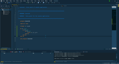

Work environment:
Windows 11 Professional  23H2
VS 2022 community 17.9.6
OneAPI 2024.1
This environment works fine for a long time.

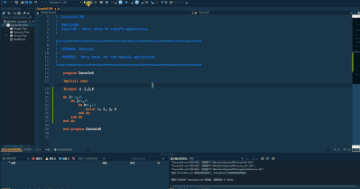

I was running a Fortran program and it paused unexpectly, so I had to close it manually.  Then I found out that I cant run no Fortran code at all. It always stopped with this error message:
"No symbol file loaded for libifcoremd.dll" 
The console then exterminate itself with no message.
I`ve checked all related posts about it and I`m pretty sure the code is correct.
It now could not even run this simple code correctly:
I`ve reinstalled the oneapi and visual studio. No thing changed.
What message else should I provide to deal with this situation?

I`ve figured this out by myself. It may be related to some error about the Visual C++ Redistributable. I reinstalled it, reboot, and the code now runs quite fine.

Your program is crashing and the debugger is starting.  This is the warning message that there is not a debug version of libifcoremd.dll.  It can be ignored.  What is happening is that your program is aborting, crashing.
Please try to compile and run a simple Hello World.  Or you can set a breakpoint at the start of your program, step through the code, and debug it.
here is an old thread on this message you see https://community.intel.com/t5/Intel-Fortran-Compiler/No-symbol-file-loaded-for-libifcoremd-dll/td-p/1098337
