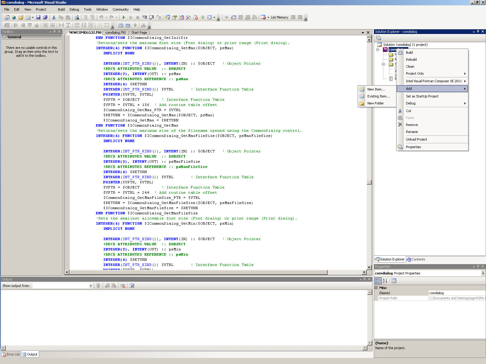

At this stage it might be a good idea to take a couple of screen shots of your VS window (using the Print screen key with one hand while holding the mouse in place with the other), pasting each in turn into a picture editor and saving them as JPG's and then posting them here.
I attach two examples fro my VS2005 window: the first is a screen shot showing the solution explorer and the second shows what I get when right-clicking the mouse on the project. Clearly you should be able to add files to a project.
To create a new project, just use the File...New project menu item.
