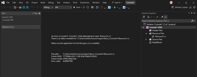

When I try to open the project Console1 that you sent, I get a series of messages like the one below:
Then I get the following:
When I right-click the resource from the solution explorer I do not get a compile option:
 In Windows Explorer it shows Resource1.rc as a "Resource File" and not a "Resource Script".  It looks like it associates *.rc files with a different application.

 As you work through the set each one slowly disappears as an error, but you only get one error at time. If you do not fix these it still compiles but the rc window is text not the nice form.   Final rc window not text now.
This is latest PReview and IFX.

Open Visual Studio | Project Console1 | Double click on Resource1.rc | It still gives: "fatal error RC1015: cannot open include file 'winres.h'
