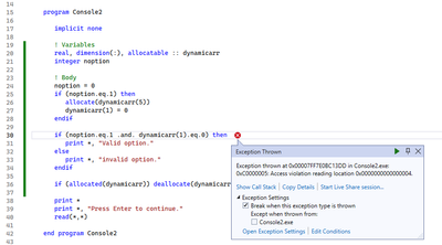

In following statement dynamicarr is allocated when noption=1. This statement executed fine in IFORT but IFX gives access violation exception.
noption = 0
if (noption.eq.1 .and. dynamicarr(1).eq.0) then
Same exception occurs on optional parameter check. If optional parameter is not passed to a routine then following statement gives access violation exception.
if (PRESENT(ioptional) .AND. ioptional.gt.0) then

Fortran as per the standard does not enforce short-circuiting such composite logical expressions. That it seems to have worked in IFORT is a mere coincidence. You should simply not rely on it, as it is quite possibly depending on the compiler options you use besides the complexity of the expression and many other things. Other languages do enforce this (C for instance) or have special operators (Ada, IIRC). There have been proposals for Fortran - operators like .andthen. and .orelse. But they are not part of any standard at this moment.

Replace
by
if (noption.eq.1) then
   if( dynamicarr(1).eq.0) then
end if
The compiler is allowed to evaluate expressions in any order, so sub-expressions should be possible to evaluate in any order.

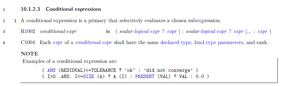

Starting Fortran 2023, the following will be an option given the conditional nature of the desired instructions:
if ( noption == 1 ? ( dynamicarr(1) == 0 ? .true : .false. ) : .false. ) then
if ( present(ioptional) ? ( ioptional > 0 ? .true. : .false. ) : .false. ) then

Fortran 2023 adds conditional expressions that will help you here, once supported. For example,
if (noption .eq. 1?dynamicarr(1) .eq. 0) ...
FortranFan
3,551 Views
@Steve_Lionel wrote:
Fortran 2023 adds conditional expressions that will help you here, once supported. For example:
However, the standard requires a clause for when `scalar-logical-expr' (e.g., the expression "noption .eq. 1") evaluates to `false`:
Thus a colon and a following expr is required, say the following lines, making the statement a bit more verbose than a Fortranner might be prone to presume:
Steve_Lionel
3,502 Views
Right - I missed that. Thanks.
