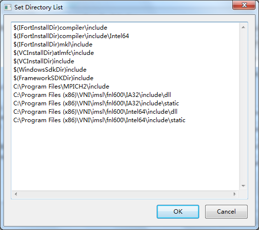

I set the project include path ,but errors still. See details from Attachments.

I noticed from the screenshot that the list of directories specified in Visual Studio for locating include and module files contains both the X64 and IA32 directories. That amounts to asking for trouble in advance.
