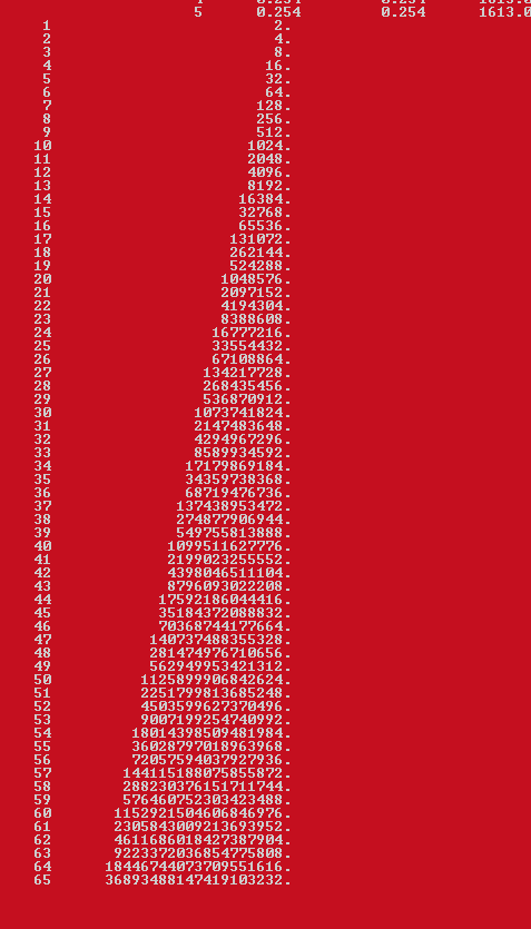

The beauty of using LISP is you learn that the brackets are really important.  Fortran tends to get sloppy and not use them and rely on the standard rules of math conventions.  You half used brackets which is dangerous in long Fortran equations.
Here is a Fortran output for the equation
The equation is Y = ((X**N)-1) in and in LISP FORM  (setq Y  (- (** X N) 1)) of course you can place any X and N within reason, but you need double precision to hold the output.  The number you seek is 2 to the 63rd power and for some reason you subtract one.  Both are sort of randomish numbers.
It is always best to check your math with Fortran first.  EXCEL and other programs are number limited as @mecej4 kindly explained.
