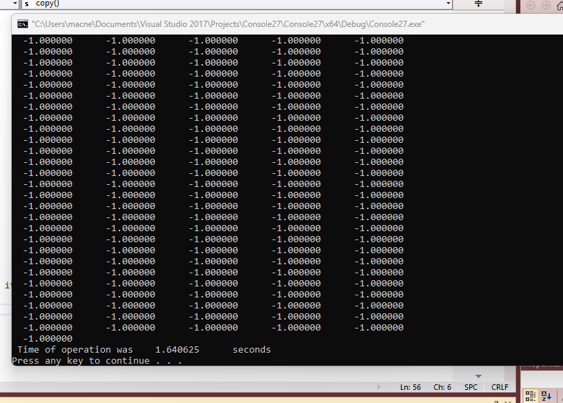

JNichols
2,083 Views
I am sorry, but I really object to be told what I do is silly, etc..
I understand your points, I respectfully disagree with the statement is adds functionality, all it does can be done in a few steps and is shown in Jim's C code.   If you cannot compare C code to Fortran I am sorry. The code changes to test it are trivial.
It is the sample provided in the Intel Documentation, I used their sample.
If you wish to believe it adds functionality that is your right, as it is my right to disagree.  It is a poorly thought out function but you can use it to your heart's content.
I have no interest in this function and it is a silly function, it could have a lot of uses with a simple switch, but to say it resizes an array is important or necessary is your thoughts, not mine.
At this stage I am rather tired of talking to people about a silly function that has vey limited use.  Use it,  enjoy it, but understand some people prefer speed over simplicity.
The original author said:
In the example below I don't understand why the call to MOVE_ALLOC returns a negative ERROR value (-858993460 to be precise) when it seems that the call was successful. This is with ifort classic 2021.5.0 (Windows platform, x64).
He should be aware from following this forum that that Intel Fortran assigns -858993460 to all unassigned integers - see picture --
He should have assigned a known value to error before he sent it into the function.  He realized there was something wrong as Intel confirmed.
The fact that this has not been found challenges the comment that is used a lot.
Finally :
call move_alloc (Y, X)  ! X is now twice as big as it was, Y is
                                ! deallocated, the values were not copied from Y to X
The comment says Y is not copied into X, but the example text says it is?  It would be nice if the documentation was the same in two places.
Enjoy your function.
This has been discussed in the last few months.
I am calling it quits, sorry, but you are entitled to your view, I do not appreciate disparaging people who have a different view.

Move_alloc timing
move_start - subroutine in module base
100 loops - 2000 entries
I fully and completely understand what you are saying.  I cannot see that it is faster, maybe if you get to 1,000,000 entries.
At 100000 entries, move_alloc is 0.4 seconds slower for 1 loop.
Please do not reply I am not going to read any further.

I profiled Console27 as provided, using VTune.  About three quarters of the total execution time was spent in functions called to handle input/output (all those print statements).  There's additional array setup overhead that also should ideally be excluded from the timing loop.
Timing results from Andrew's example seem reasonable (I don't think the example is conforming though - is the second half of the expanded variable defined?).  They are consistent with measurements here with a different example (and the optimiser did foil my initial attempts).
Shortest source code length wise, but likely inefficient runtime wise (unfortunately - Fortran compilers appear to lack the high level transformations for optimising this), for expanding allocatable arrays is simply something like
array = [array, extra_stuff]
