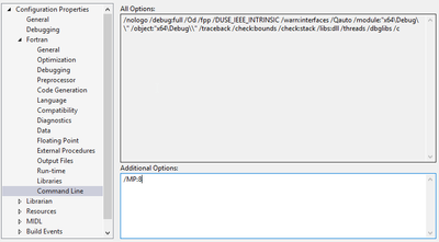

I'm using IFX from the HPC-Toolkit 2025.2 with VS2022 integration on a Windows Server 2019 with 96 logical cores. When I set multi-processes compilation in the ui
on a project (BLAS), then the compiler immediately spawns many processes which results in stalling of the server and finally I get the following output:

Also, trying to limit the number of process with e.g. /MP:8
doesn't have any effect on the compilation speed. (Same compilation speed as without specifying /MP)
