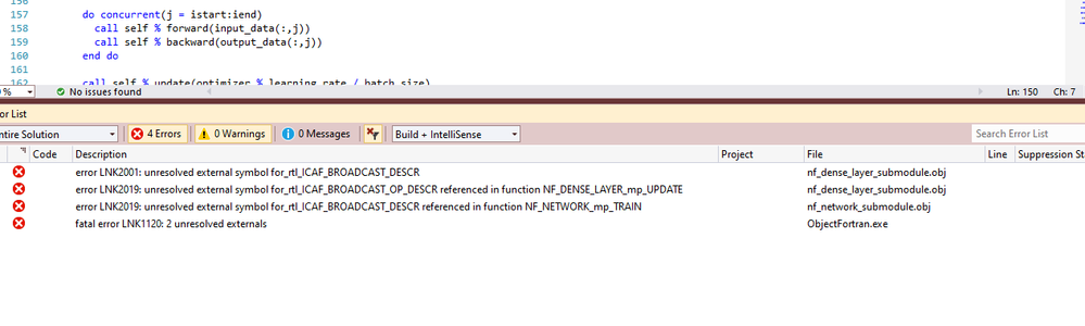

I loaded the code into a VS Project,  I get the errors in the first picture,  if I comment them out, the program runs although it is not likely to be correct.
The cmake commands are shown in the 2nd picture for Fortran.  How can you have release and debug flags at the same time.  And in the properties page I could not find coarray single

This isn't hard. I loaded the sources into a new project, chose simple.f90 as the main, set the options /standard-semantics and /Qcoarray, then built and ran it. The missing for_ICAF routines are due to not asking for coarray support.

I got them all running in VS 2019.  As noted I needed to turn on co-arrays and standard semantics.

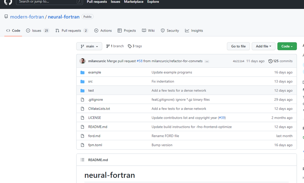

As @FortranFan suggested I will post the only problem I had on the Discourse website, as I cannot find the mnist.tar.gz file on the owners github.  It is supposed to be in a directory call files, but it does not seem to exist on the git hub site for the developer.

@FortranFan  thanks for the help. The Fortran Discourse community loaded the file overnight and put up some explanation as well.

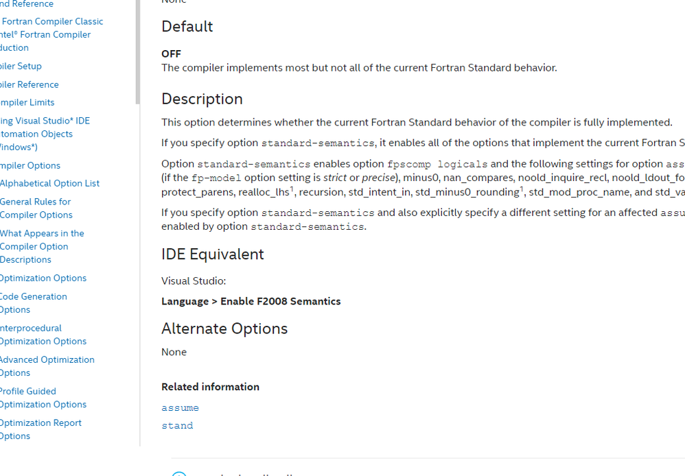

/standard-semantics is shorthand for a bunch of options that tell the compiler to behave the way the current standard says, rather than the way Intel/Compaq/DEC Fortran has "always done it", due to changes in the standard over the years. For details see standard-semantics (intel.com)
The particular setting you seem to be interested in is /assume:byterecl.

The development team uploaded a copy of the mnist database for use with the program.

I got a stack overflow so I had to turn on heaps-array.
There is a minor error in the Intel Documentation.
The note should say 2018 semantics  as that is what comes up in the VS property page.

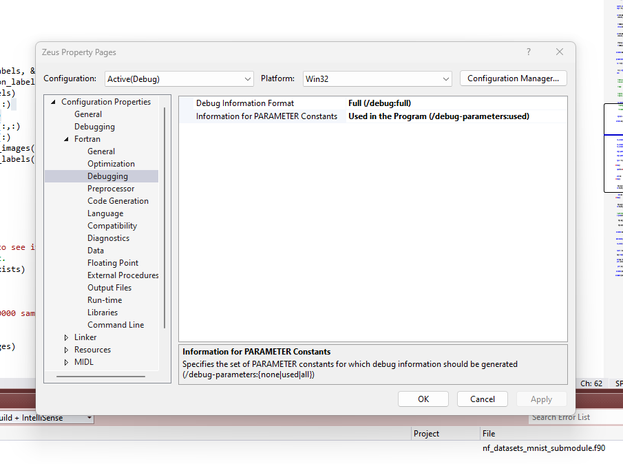

I got the following error:
When I turned on information for parameter constants - I include the program that showed the error.
It runs if I turn off the switch.
The program has parameters scattered within, I am slowly trying to clean them all into base as I was taught by @mecej4 , but it takes a while.
