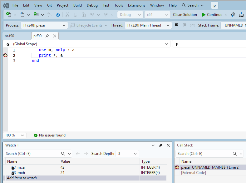

To add to OP's post, please consider a trivial module file m.f90 in a Visual Studio project as follows:
module m
integer :: a = 42
integer :: b = 24
end module mAnd a consuming program like so:
use m, only : a
print *, a
endAs mentioned by OP, the USE statement with ONLY clause masks the object in the debugger:
Whereas without the ONLY clause, the debugger identifies the object - see below:

Hi, I did reproduce your observation about the private/public attributes, but couldn't reproduce that with "only"
It still can show the value of a, even I have the "only" specifier in front of it. Did I miss anything ? Do you have the Intel Fortran Expression Evaluator installed ?
I'm using VS2026 and ifx 2025.3.2.

Hi, Please continue to use module::variable in the watch window as a workaround.
I can reproduce your observation now if I only enter "a" instead of "m::a" in the watch window. And if you hover the cursor above the variable during debug, it doesn't show its value. This is indeed somewhat inconvenient.
As far as I can understand now, this seems a deliberate design in the compiler, that for code "use m, only : a", no new variable is created, instead it's replaced with "m::a" during compile time and that's why you see the error "Undefined variable a" when trying to see its value.
I have escalated this issue to the compiler team and will get back once I get any updates.

Hi, I have some updates that the issue has been fixed with the 2026.0 release. Please verify when the package goes public.
Right now, the variable "a" can be resolved in watch window, it also shows up in the locals window and when you hover your cursor on it.
