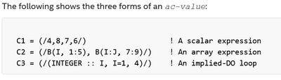

In the compilers documentation for array constructors (as linked above) - the expression provided for the assignment to C3 in one of the examples has a syntax error. The INTEGER :: type spec is in the wrong spot - it can either go before the second opening parenthesis (specifies the type of the entire constructor) or after the first comma (specifies the kind of the ac-do-variable, as per the feature discussed above).

- I filed DOC-9465 to correct the example in the Fortran Developer Guide and Reference.
