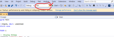

taehunkim
1,152 Views
If you change from x64 to win32 in configuration manager (MSVS), it works well.
Thanks.

1,136 Views
Dear Taehunkim
this is definitely no solution. I would not want to sacrifice computation efficiency just to be able to plot a bitmap in the pre-processing. Changing to Win32 brings along a whole bunch of other issues in my codes.
I hope you can update IFX soon.
BR
Kai
andrew_4619
1,097 Views
      You cannot do a 32 bit build with IFX.
