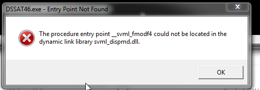

Dear Steve,
I am facing similar errors when I try to run the released version of my code in Fortran in other computers. Both, the debug and released version are able to run on my computer without any error. However, when I try to share the executable as released version, the people are getting errors as the image below: The procedure entry point__svml_fmodf4 could not be located in the dynamic link library svml_dispmd.dll.  Also, other people get an error related to some libraries that are missing (libifcoremd.dll, libifportmd.dll, libmmd.dll, svml_dispmd.dll) how could I solve this error? is it a configuration aspect?
I have  Microsoft Visual Studio Enterprise 2015 and my compiler is Intel® Parallel Studio XE 2016 Composer Edition for Fortran. I have Windows 10 Home.
Steve_Lionel
6,133 Views
You need to install the Intel compiler redistributables. See https://software.intel.com/en-us/articles/intelr-composer-redistributable-libraries-by-version. Install the latest version.
