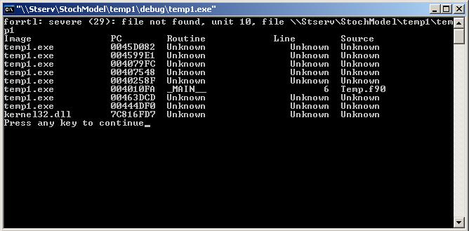

Hello:
I have created the following simple test program:
program
Test
open(10, name='temp1', status='old', err=1)
stop
1 open(10, name='temp1', status='replace')
end
It works fine (i.e. it doesn't crash) when I run it from my local machine. But when I copy the solution and project to a server directory (to which I havefull write permission), and run it from the server, it crashes at line 1 saying that it can't open the file. I noticed, though, that if I change the file names to "D: emp1" (so that it's trying to open the file on my local machine), then it runs, even from the server.
This seems strange to me. What am I missing? Is it perhaps a compiler bug?
Thanks.
Michael

I have attached a screen shot of the error message showing that it crashed when trying to open the file.
By running from the server I mean that I copied the entire solution folder (and contents) to a server on our network and rebuilt the solution. (The rebuilding was probably unnecessary.) I then ran it from that solution on the server using "Start without debugging". Practically, I think the only difference between running it on the server and runnning it on my machine is the working directory of the program when it executes.

No, I do not see that message. The screenshot that I posted is exactly what I get.
I tried mapping a drive and running it from the command line using the mapped drive, but got the exact same results. I've attached another screen shot of the error usingthe mapped drive.
