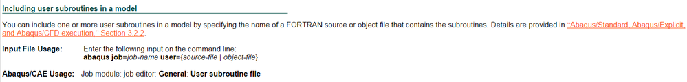

Now I see you're using Abaqus 6.14; even though I couldn't locate the user guide online for this version, it is available for version 6.12 here: http://www.maths.cam.ac.uk/computing/software/abaqus_docs/docs/v6.12/books/usb/default.htm.  The user guide for 6.12 says you can include user subroutines in either source file form or in object form.  I assume things have not changed in this regard in your 6.14 version.  Assuming that to be the case, try the following: copy your exa_hydfracture.f file and aba_param.inc file (you may need to do a file search for this on your system to locate it in one of Abaqus folders) to c:\temp folder.  Then follow the step as with hello.f above: go to the IA-32 command prompt for Intel Parallel Studio, type ifort -c exa_hydfracture.f  to compile the file.  It should create exa_hydfracture.o file; keep it handy.
Now notice in the Abaqus user guide, it says you can supply the user file is source or object form using the command such as "abaqus job=job-name user={source-file | object-file}".  So instead of providing the exa_hydfracture.f file as in user=exa_hydfracture.f, try supplying the compiled exa_hydfracture.o file.  This might help Abaqus figure out that no compilation is necessary and that it does not need to use ifort.exe, and bypass all the complications with PATH and ifort, and directly utilize exa_hydfracture.o file.  And once Abaqus has the compiled object in the form of exa_hydfracture.o file, it should figure out how to make use of it and this stage, whether the object was created using Intel Composer 2011 or 2015 may not matter one bit.  And this may allow your calculations to proceed.  Would you mind giving this a shot and reporting back here?
