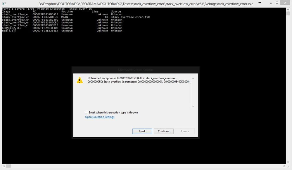

Hi everyone!
I have been having problems with stack overflow error when I am trying to operate arrays through a function implemented in a module. The problem occurs only with arrays larger than 300x300.
I reduced and generalized the code to find where the error is and even then the problem reoccurs. I even compiled on two different computers with different versions of Visual Studio and Intel Parallel Studio and the error remains the same.
Has anyone experienced this same problem? What can I do to solve this error? Is there any compiler option to solve this problem?
The university computer that I am using has installed Microsoft Visual Studio Professional 2013 Update 3, Intel Parallel Studio XE 2016 Update 2 Cluster Edition for Windows.

Attached are also two printscreens with the errors that appear when the program makes the operation with the array 400x400, one when is compiled in 32-bit and the other in the 64-bit.

Your function returns an array whose size is run-time dependent on the size of its argument. The compiler has to create space for this and does so on the stack by default. On Windows the stack is 1MB by default, so it's easy to overflow this.
The easiest solution is to set the project property Fortran > Optimization > Heap Arrays to 0. This will cause the array result to be allocated on the heap instead of the stack. Another choice is to set the Linker > System > Stack reserve size value higher. You may have to experiment to see what values work - don't make this much bigger than necessary.

Thank you Steve!
Yes, I wrote this toy program trying to isolate and find out where was the error on my real program. In my real program I was following the idea of http://fortranwiki.org/fortran/show/Matrix+inversion to facilitate the use of DGETRF and DGETRI routines of LAPACK library for inverting matrices. First I thought the error was because of some limitation of routines DGETRF and DGETRI but reducing and isolating the error until I get the code lines that I posted I realize that the problem was not in DGETRF and DGETRI routines.

I put "10000000" (10 million) in Linker> System> Stack Reserve Size and worked perfectly.
