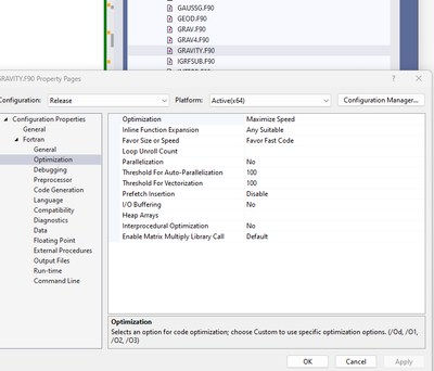

Here's how I approach problems such as this. Assuming the application is made of separate source files, I compile half of them as "Release" and half as "Debug", then see if the problem persists. If not, I switch. Once I establish which set, compiled "Release", still shows the bug (assuming I can)., I than take half of that set and compile Debug. I repeat this process until I have the minimal set, compiled Release, that still shows the problem. (This isn't always possible, but it works more often than not.)
Now that I have that minimal set, I start reducing compile options to get the minimal set that still shows the issue. In most cases, I end up with a single source file that is the culprit. The others I will build with full compile-time and run-time checks, including generated interface checking. What follows is then a slog of reducing the problem source file, commenting out sections to see if I can narrow down which line(s) are involved.
This is not a quick method, and sometimes experience with it helps, but it rarely fails me in the end.

I understand the concept of your proposed approach, but I am confused about how to do it.
Are you saying there is a way to specify a file to be compiled as debug while the rest is compiled as release? Or am I compiling a module and file on its own without a main program?

Perhaps instead of Debug and Release I should have said optimized and unoptimized. It may actually make more sense to reduce the compile options first. I don't know your build environment, but when I use Visual Studio on Windows, I select a set of source files in the project, right click, select Properties, and then change the setting I want to adjust - this applies to all the selected files. Visual Studio will show a slightly different icon for the file to indicate that it has non-default properties.
If you are using a command script, it's a bit more involved.

To expand on @Steve_Lionel response
You Right-Click on the source file, select Properties, select Release configuration, set Optimization to Disable.
Note, for source files that have other than Project Defaults, an almost unnoticeable red tick mark appears on the Icon of the file.
Later, you can use this to locate the altered files to undo the alternate selection.
Jim
