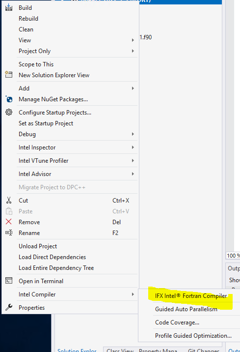

Been running oneAPI ifort under VS2022 for a while & with the latest oneAPI 2024.1, got the notice of ifort going away & the recommendation to switch over to ifx...OK.
I thought, from within VS2022, the switch from ifort to ifx should be fairly simple... right-click on the IFORT Solution>Intel Compiler> and the choice should be listed to choose. However, within the 'Intel Compiler' is only:
Guided Auto Parallelism
Code Coverage...
Profile Guided Optimization...
What needs to be done to get the ifx selection option visible?

Make sure you are using a 64-bit build configuration.  Check this article for details

Thanks...but that is the problem - it's not listed as an option to switch to.
Within the Configuration Manager, the only things listed are:
Win32
<New...>
<Edit...>
Now, when I create a project from scratch, it defaults to x64 & IFORT is available to switch to but why is that option not available for a preexisting project?

With preexisting project - in x64 configuration there is an option to switch compilers between ifx and ifort. Right-click on the project and select Compiler
Steve_Lionel
1,826 Views
It is available in old projects, but only if you have selected an x64 configuration, if it exists. Really old projects won't have one by default, so you'll have to add one in the Configuration Manager.
