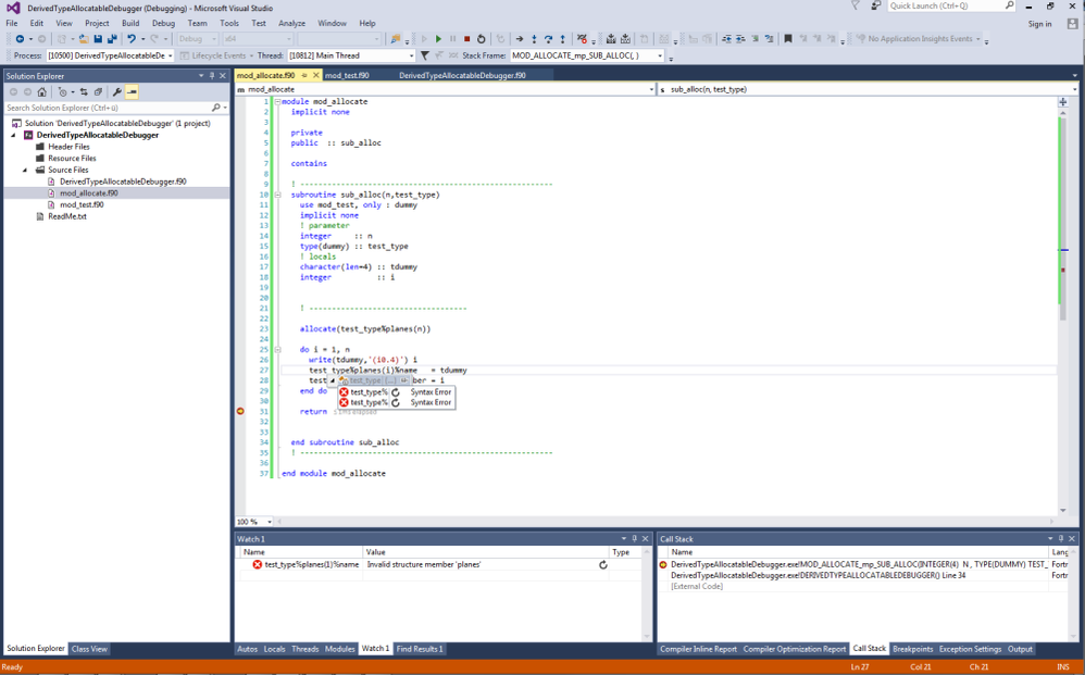

today I stumbled over an issue in the debugger extension into VS 2015 (update 1). I have a dereived type with again derived type sub-component which is allocatable. In a module I allocate this sub-component. The debugger shows a 'syntax error' in hover over. However, I'm not sure whether the code is conforming to standard.

The error looks like:
Any hint what is wrong?

I don't see anything wrong with your code and will send this along to the developers. Thanks. Issue ID is DPD200379544
Steven_L_Intel1
948 Views
I am told that the fix for this will be in Parallel Studio XE 2016 Update 2.

The screenshot is
An extension of the debugger for this case would be fine.

I'm not seeing this problem in 16.0.2. I note that the source, as you present it, has the program before the modules. If you hadn't recompiled the source earlier, the program would get the old modules.
Please move the program to the end, rebuild, and try again.

thanks for the information. Actually the program and the two modules are in three different files. Nevertheless, I cleaned the solution, built it and checked again. The debbuger shows me still a 'syntax error' for 'test_supertype%dummy' planes and lines sub-components in hover over and in watch window. The shell output is as expected.
The original example is OK and wasn't in 16.0.1, so I assume the 16.0.2 integration into VS2015 sp 1 has been OK. I attached the whole solution as zip. Maybe I do something wrong in there.
Best regards, Johannes
Steven_L_Intel1
948 Views
Ok. It works in 32-bit but not 64-bit. Strange. I will let the developers know. New issue ID is DPD200382235.

This last will get fixed in Update 3.

I can confirm that 16 update 3 solves the issue (32 and 64 bits). Many thanks to the Intel team.
