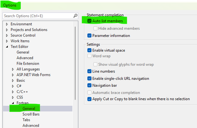

In the latest Fortran (In VS2022)  the Auto list Members feature has come to my attention because it has been irritating me. I do not know if it is a new feature, a modified feature or a features where the default has gone from unticked to ticked, maybe someone could clarify?
I can see it is a useful  feature but what is irritating is that when autocompleting surely it should respect the case the user is using i.e. if I am typing in lowercase it autocompletes in UPPERCASE irrespective! I am sure some people love their uppercase FORTRAN  but I think many do not, it is no longer 1977. The solution is to untick it however a **feature request** is that is that it respects the case of the user typing that invokes it. Or maybe some other setting does that already??

I have had the same experience recently and have disabled this statement completion feature in VS2022 out of annoyance. I note that the uppercase notation is only there for Fortran intrinsics, such as functions SUM, ALLOCATED, but not for keywords like allocate or module, which are completed in lowercase notation.

....also things like .AND. and .OR. get uppcased.
