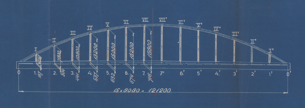

Standard bridge method as a case in point:
If you calculate all of the points as (X,Y) the original will contain errors, guaranteed, the people who build this by hand coped with the errors, we used to do this all the time, but it is simpler to send the critical information
2 parabolas, a shape with 14 hangers and the hanger spacing == on a 121.2 m length. In creating the parabolic data, which is six reals, you can do an error analysis, so for one bridge the maximum error was 45 mm, but the parabola meant it is smooth when built which is what I want, if the parabola gives 16825 and that is a better fit to make a smooth differential then who cares, in this instance, as long as you check all the other dimensions.

I used to get paid a lot of money to sort out these errors.

I agree we have different problems, but the note that you only require certain entities is what is normal for all people, no one ever needs everything.
I look at old bridges and model them to look at measured data.
The only thing of importance is efficiency and accuracy.
