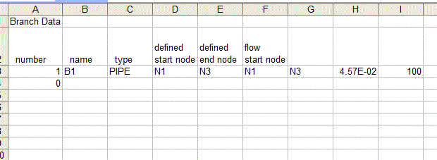

Any idea How I can get, eg.
defined
start node
in one cell?
This program forms the output with LF and CR in the correct places, I tested with excel 2003? [fortran] program Console3

end subroutine addstring[/fortran]
Actually it does work, just that you have to turn on Word Wrap in Excel! My original format worked too...
