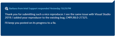

I have put a ticket yesterday and they aswered this (I paste it here because it has nothing confidential, I guess, I hope Barbara is not going to be mad at me), they added it to some other open bug:
The problem is that  I am stuck in version 2019 update 2 due to other bugs that I submitted before to Intel (not corrected until 2020 update 1).
It is quite annoying, it seems that not many people are working on the fortran compiler nowadays, I currently have 7 open bugs with them...
