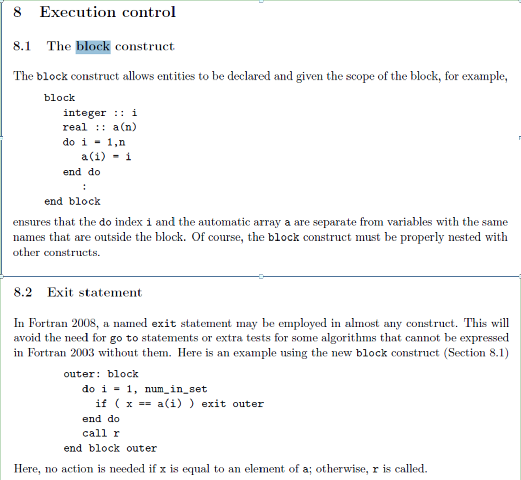

Oh well, the example I gave in Quote #5 is not yet functional in Intel Fortran because the EXIT statement does not work inside the BLOCK construct.  But note this example works correctly in gfortran 4.9.
Steve, can you indicate whether the EXIT statement aspect will make into the compiler 2015 version along with BLOCK?
Here's an explanation of these two features by John Reid in "The New Features of Fortran 2008" document:
Steven_L_Intel1
3,861 Views
We're aware of this feature - it's on our list, but not currently implemented and probably won't get done for 15.0. I have reminded the developers about it.

Hack(barf)
outer: block
outer_block: do
  do i=1,num_in_set
    if(x==a(i)) exit outer_block
  end do
  call r
  exit outer_block
end do outer_block
end block outer
I am aware that an IF statement can be named. The user guide I have does not state if the EXIT name can be used to exit a named IF statement/block. You could try it if you want (it will look cleaner than the dummy DO loop and you won't need the extra exit at the bottom of the dummy loop.
Jim Dempsey
Steven_L_Intel1
3,861 Views
We don't yet support the enhanced uses of EXIT as specified in F2008, including an IF block.
