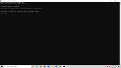

Omran
4,058 Views
Thanks for your fast response, excuse my ignorance,
- I am running the DLL through an .exe program already
- I did what's required and still receiving the same error (see picture attached)
-I have checked and mine is 64-bit
-I added the line to the .bat it did not work
Steve_Lionel
4,046 Views
It's odd that you didn't see any output from setvars.bat. Here's what it should look like:
What happens if do the "call" first?
Omran
4,006 Views
Nothing is shown in both ways, I will uninstall and reinstall all oneAPI toolkits (Base and HPC) and will try once again
Omran
4,001 Views
@Steve_Lionel  I have uninstalled oneAPI Base and HPC and Fortran compiler, Then only installed the Fortran compiler,
and then followed the steps you provided. It worked perfectly! Thank you for your time!.
