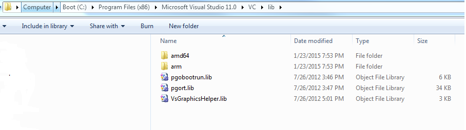

Using Visual Studio Professional 2012 and Intel Visual Fortran Composer XE 2013 SP1, I get "fatal error LNK1104:  cannot open file 'LIBCMTD.lib'" when trying to build a solution.
I have 'LIBCMTD.lib' in directory C:\Program Files (x86)\Microsoft Visual Studio 11.0\VC\lib\amd64 and the x64 Libraries has "$(VCInstallDir)lib\amd64" where $(VCInstallDir) has value C:\Program Files (x86)\Microsoft Visual Studio 11.0\VC.
What am I missing?
Thanks, John

Are you building 32-bit or 64-bit objects? The directories that you listed are for the 64-bit versions of the C libraries. Do you have corresponding 32-bit libraries?

Do another build. Create a ZIP of the buildlog.htm from the failed build and attach it here. This will help us understand where the problem might be. There should be a LIBCMTD.LIB in C:\Program Files (x86)\Microsoft Visual Studio 11.0\VC\lib as well as in the folder you found.

Hi Steve, I did not have "LIBCMTD.lib" in C:\Program Files (x86)\Microsoft Visual Studio 11.0\VC\lib, there was only one in C:\Program Files (x86)\Microsoft Visual Studio 11.0\VC\lib\amd64.  I compared my C:\Program Files (x86)\Microsoft Visual Studio 11.0\VC\lib directory with another coworker whose Intel Fortran works, my C:\Program Files (x86)\Microsoft Visual Studio 11.0\VC\lib is missing many files.
If I add LIBCMTD.lib from the other coworkers Intel Fortran that works to C:\Program Files (x86)\Microsoft Visual Studio 11.0\VC\lib then there is another file which cannot be linked.  Here is the C:\Program Files (x86)\Microsoft Visual Studio 11.0\VC\lib directory which I had after installation of Visual Studio 12 and Intel Visual Fortran Composer XE 2013 SP1.  Where do I get the rest of the files? Attached is the buildlog.htm from this setup. Thanks,  John

You need to reinstall or repair your Visual Studio 2012, then, as you've lost the 32-bit Visual C++ support. This is required by Intel Fortran (if you're not using our bundled VS2010 Shell and libraries.)
