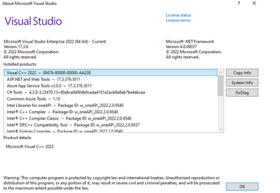

thanks Jim and John , I am using WIndows 10
this is from help\about
and
The issue came out of the blue about 2 weeks ago. It may have been caused by an update , but completely unsure why i have the problem
