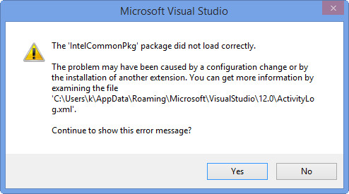

dasta_u_
初学者
2,915 次查看
Hi
when i was installing this software, at first loading of the program (intel fortran 2015 on vs 2013) a panel pop up apeared and asked me to select a default program and i have mistake and i select F# instead of intel visual fortran and problems of font, comment and ... color started
i think maybe the problem related to my experience.
thank you

Steven_L_Intel1
2,915 次查看
I'm not sure what you would have done to trigger such a popup, but if you caused .f90 files to be "associated with" F#, then I could definitely see this as an issue.
Try this:
  1. In the Windows search box (lower left of screen, click Start button if on Win7), type regedit.exe   When you see the program appear in the search results, click on it to open regedit.exe. Administrator privilege is required.
  2. Click on the + or triangle to the left of HKEY_CLASSES_ROOT
  3. Scroll down and find the entry for .f90 in the left column
  4. Click (once) on .f90 and press the Delete key to delete that registry entry
  5. Exit regedit
  6. Do a "repair" of Intel Parallel Studio XE from Programs and Features.
0 项奖励

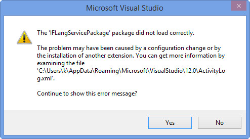

dasta_u_
初学者
2,915 次查看
I do the above procedure and the problem is exist yet; Maybe i have mistake in the cause i said.
But this two errors shown when i run intel visual fortran:
1. the 'IntelCommonPkg' package did not load correctly.                    http://s6.picofile.com/file/8223874334/error_1.jpg
2. the 'IFLangServicePackage' package did not load correctly.            http://s3.picofile.com/file/8223874376/error_2.jpg

Steven_L_Intel1
2,915 次查看
I suggest an uninstall and reinstall of Fortran then.
