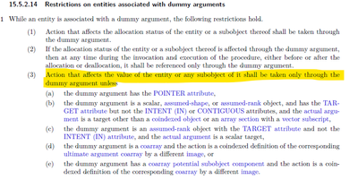

This is an invalid program. It violates:
In other words, you're aliasing the dummy argument and the COMMON variable, and that is not allowed here.

@Steve_Lionel, thank you so much. It was a bit hard for me to understand those sentences with "unless".
So, it is time to update 40k LoC with this violation...
Steve_Lionel
3,887 Views
You can, for now, compile with /assume:dummy_aliases and I think it should do what you want. It is still invalid code.
All of the "unless" bullets are cases where you are allowed to make aliases - the TARGET attribute (implied by POINTER, which I think is relevant to your other thread), is one of these.
One of the core tenets of Fortran is that aliasing is generally disallowed, unless you tell the compiler explicitly that it can occur.

@Steve_Lionel, thank you! With `-assume dummy_aliases`, all tests were passed. And thank you for explanation  about Fortran.
