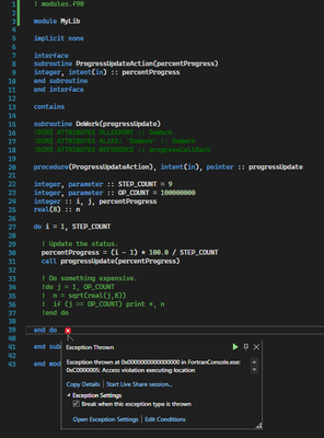

I have a fairly simple console program that takes a single argument from the command line and the implements a progress update (to eventually be used in a larger program) ...

When I try to debug the code in VS2022 (v16.0.6), I get this ...
... which looks to be where the call to progressUpdate is made.  If I run the executable from the command line I get this ...
My compiler/IDE/etc. setup (which is all the latest installs) ...
Am I doing something wrong in implementing the interface?  Is the procedure/pointer throwing things off?
Many thanks.

In the blog post that you link to, the author has written the equivalent of a Fortran procedure in C# that does something (it writes to the console) when the DoWork subroutine requests a progress update by invoking the progressUpdate procedure pointer. There's nothing equivalent to that in your code.  How does your code know what to do when a progressUpdate is requested?
You could write a procedure something like:
module MyThings
  implicit none
contains
  ! This procedure matches the characteristics
  ! defined by the ProgressUpdateAction abstract interface
  ! in the MyLib module.
  subroutine my_progress_updater(percentProgress)
    integer, intent(in) :: percentProgress
    write (*, "('I am about ',i0,'% of the way there.')")  &
        percentProgress
  end subroutine my_progress_updater
end module MyThings
and then pointer assign progressUpdate prior to the call to DoWork
use MyThings
progressUpdate => my_progress_updater
call DoWork(progressUpdate)
(The author of the blog post made the progressUpdate thing a procedure pointer possibly because of some idiosyncrasy associated with interfacing with C# (or possibly because they just like pointers).  But there's no need for it in a a Fortran-Fortran case.)

At a first glance I would say that you forgot to define the procedure pointer. At least, I do not see a statement like:
progressUpdate => progressUpdateAction
or something similar.

Definitely nothing too wild :), but what I meant to explain is that the pointer you pass to the routine DoWork must be pointing to an existing routine. Now you use the name of the interface. Your second solution is the way to go (because otherwise you could leave out the argument altogether), but you need an actual routine to do the work.

Thank you @Arjen_Markus and @IanH .  Your responses have provided the solution I was looking for.  I really appreciate the speedy replies.
I have updated my code and it compiles and run fine.  Here is where I ended up ...
