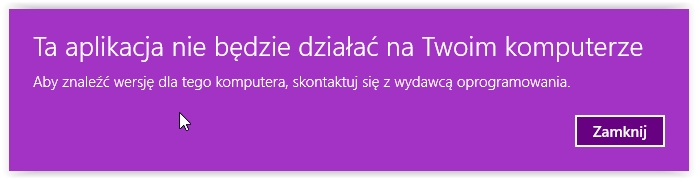

Dawiduser143
3,796 Views
Spreg.exe doesn't work. Permission denied and system only show message like on the screenshot. I'm working on administrator account permissions. Delete registry files do nothing. Change "\"  to "/"  line "C:\Users\river\Documents\GPA in MonitorConfig file also doesn't work. "Is it generating dump files constantly until Graphics Monitor is closed?" - no, only when turn on the program, this is infinite loop when program is running.   2024R3 works without any problems, also with disabled developer options, but R4 brings only new problems on my device.

Hey Dawiduser143,
Apologies - it turns out that the January hotfix was for a separate issue and did not include the fix for Graphics Monitor Sever crashing. A fix for this issue is targeted for the upcoming 25.1 GPA Release.
Thank you for the additional information and clarification. Could you try this workaround?
  1. Navigate to your GPA install directory (C:\Program Files\IntelSWTools\GPA)
  2. Delete the following .dll files: EMONPlugin.dll and NPUPlugin.dll
Let me know if this works for you. And sorry about the incorrect information regarding the hotfix, I have edited my previous posts to reflect this.
Dawiduser143
3,720 Views
Delete a EMONPlugin.dll file is resolving the problem with creating a dumpcrash files and crashing monitor server notification. NPUPlugin.dll deleted or not, it doesn't matter. Thanks for help and i am waiting for the new 25.1 GPA version.
