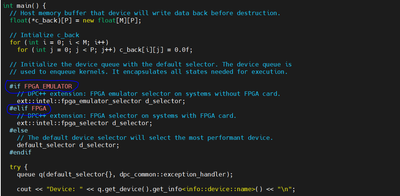

Step 3: Edit the matrix_mul_dpcpp.cpp file as below:
  • Add in the header :
#include <sycl/ext/intel/fpga_extensions.hpp>
  • Add the below under main() :
#if FPGA_EMULATOR
  // DPC++ extension: FPGA emulator selector on systems without FPGA card.
  ext::intel::fpga_emulator_selector d_selector;
#elif FPGA
  // DPC++ extension: FPGA selector on systems with FPGA card.
  ext::intel::fpga_selector d_selector;
#else
  // The default device selector will select the most performant device.
  default_selector d_selector;
#endif

Tried all these steps
Included Makefile.fpga
I think Fpga is not getting detected. FPGA_Emulator and FPGA are in red color when .cpp file is edited.
So after build
and after run nothing is happening
No output.. No error..
Is there anything else to do initially before all these steps..?
RemyaP_Intel
3,041 Views
Sharing the screenshot of the matrix_mul_dpcpp.cpp file, where you need to make the changes.
Are you saying about the highlighted part in the code? If yes, the red highlight shouldn't be a problem.
Make sure the spaces and tabs are given correctly in all the files.
If issue still exist, please send a screenshot/content of the error files.
Remya Premdas

Can you please send the screenshot of matrix_mul_dpcpp.cpp you mentioned as I am not able to see any image.
RemyaP_Intel
3,018 Views
I am attaching the screenshot and files. Please check and let us know if you are able to do the execution.
Remya Premdas
Laxmis
3,011 Views
Thanks a lot! It worked.. I guess some issue was there inside my Makefile.fpga it is working in Fpga emulator now.
