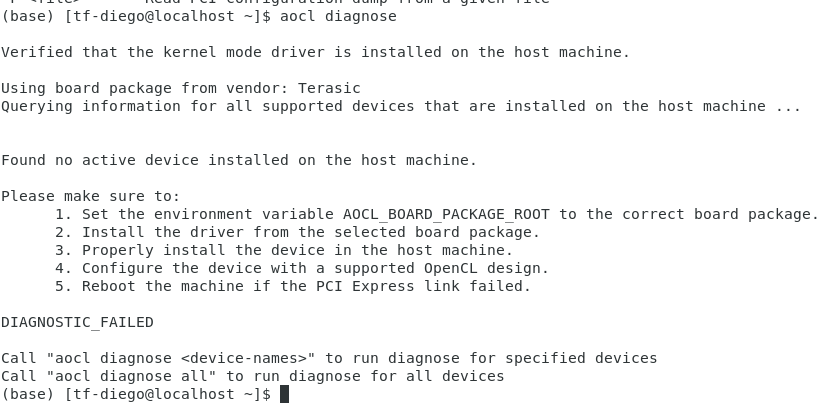

I am trying to configure a Cyclone V on Centos 7 through the PCI Express 16 port and the FPGA does not recognize me. The FPGA port is 4x. I currently have another PCI Express 16 port busy with a graphics card and it does. I have tried to change the FPGA in the port of the graphics card and it continues without recognizing it, but it does recognize me in the other port the graphics card, so I deduce that it is a hardware problem at the level of the motherboard ... I have checked the switch configurations in the FPGA and the configuration corresponds to that recommended for the PCI Expres 4x: SW5 x1 = off, x4 = on. JP8 & JP10 in 1 and 2 and JP1 in 7 and 8.
To determine that the FPGA port does not recognize me, I have made the query: "sudo dmidecode -t 9". I have also configured in the BIOS the port where I have the FPGA for "Gen1" since it indicates that the port is a "PCIe Gen1 x4", but still, the BIOS tells me that there is nothing in that slot ...
I have followed the installation documentation rigorously, but the problem is that it does any PCI Express detect the FPGA...

and finally, "aocl diagnose" command:

Interesting, I had never seen a PCI-E-based Cyclone V board before. I guess you are using the Terasic OpenVINO Starter Kit, right?
Anyway, Have you followed Terasic's instructions for getting OpenCL to work with your board? Specifically, you first need to program the board through JTAG with an OpenCL image to enable the PCI-E core on the FPGA and then reboot your machine for the board to be detected via PCI-E. It won't be detected out of the box.

I believe you should have seen the "OpenCL User Manual" here already:
https://www.terasic.com.tw/cgi-bin/page/archive.pl?Language=English&CategoryNo=167&No=1159&PartNo=4
I think your main problem is that either you have not correctly connected the JTAG cable (or connected it at all), or the cable is not being detected for some reason and hence, the aocl flash command which is supposed to enable the PCI-E core is failing. That is the problem you should focus on solving right now.
