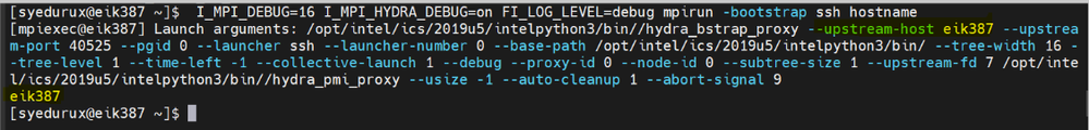

We tried running the below command on a node with Intel(R) Xeon(R) Gold 6342 CPU using Intel MPI 2019.5.281 and it is working fine at our end.
 I_MPI_DEBUG=16 I_MPI_HYDRA_DEBUG=on FI_LOG_LEVEL=debug mpirun -bootstrap ssh hostname
output from my end:

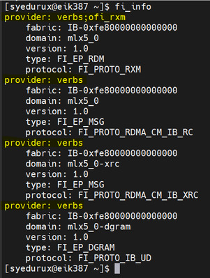

Also, could you please provide the output for the below command?
fi_info
sample output from my end:
You can try any one of the providers from the fi_info output to set the value of FI_PROVIDER.  Usually, to run an MPI job on a single node, specifying FI_PROVIDER is not essential.

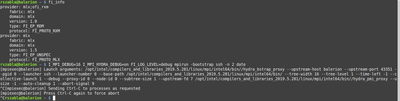

Alchemist
3,000 Views
Thank you for your answer!
I do not have an up to date license for mpiicc and just intend to use runtime, so I cannot compile the hello.c code. However, hostname and any other command/program executed in the suggested way (e.g. date, echo etc.) doesn't produce any output and spawns the hanging hydra_pmi_proxy process. Every time, I need to abort mpirun with ctrl+c and then kill hydra_pmi_proxy.
I'm attaching a screenshot including the output of fi_info:
~ $ fi_info
provider: mlx;ofi_rxm
    fabric: mlx
    domain: mlx
    version: 1.0
    type: FI_EP_RDM
    protocol: FI_PROTO_RXM
provider: mlx
    fabric: mlx
    domain: mlx
    version: 1.5
    type: FI_EP_UNSPEC
    protocol: FI_PROTO_MLX
My node is equipped with the Intel(R) Xeon(R) Gold 6248R CPU.
Rafal
