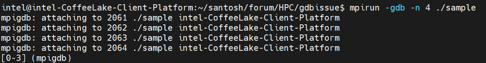

Please follow the below steps to resolve your issue:
Steps:
  1. sudo sysctl -w kernel.yama.ptrace_scope=0
  2. mpirun -gdb -n 4 ./sample
We have tried at our end & we are able to get the desired results as shown below:
Please try from your end & let us know if you face any issues.
Thanks & Regards,
Santosh
