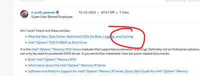

Am I sure? Check out these articles:
It is the Intel® Optane™ Memory M10 Series modules that supported acceleration (caching). Definitely not an Enterprise solution, however. AFAIK, they can only be used to accelerate SATA drives. If you are further interested, here are some related documents:
Finally, read this announcement/update: Intel® Optane™ Business Update: What Does This Mean for Warranty and Support.

Still no mention about no caching support for 1600X
PS I'm sorry. But I just cannot find any clear mention that 1600X cannot be used as cache drive. Furthermore one of your links provided data that 660p could be used in hybrid drives. That's NVMe drive.
Mentioning about End of Line concern obsolete models (M10 to be more precise). Not a single word about 1600X. Most articles are dated far before my 1600X drive was even manufactured.

660p support was a special case. AFAIK, there was never any support for doing so with 3rd-party NVMe drives.
If you read the article, you will see that they used the word 'caching' in a totally different context.

I just didn't find any clear statement that 1600X can't be used as a cache component in hybrid Optane drive...
And - in case of an other, appropriate for caching Optane drive model  - can Optane hybrid drive be assembled with another NVMe drive? Or Optany hybrid drive can be combined only with SATA drive?
Could you please clarify about the cache context article about 1600X provide? I'm not a specialist in this field. For my mind caching is always a caching. You meant it's not for Optane drive caching? I didn't find any mention of that
