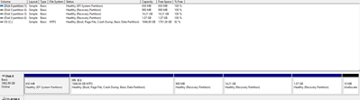

ricorocks
6,379 Views
n_scott_pearson
6,371 Views
Hhmmm, interesting. If you click on the HDD entry, does it give you the proper details for the new HDD? What exactly is it showing in the Optane tab?

n_scott_pearson
6,291 Views
The easiest is to do this is from the tool that you are already displaying. Within the Optane tab, simply choose Disable. When it is complete, you will be asked to restart. After restarting, run the tool again and, from the Optane tab, simply choose Enable.
