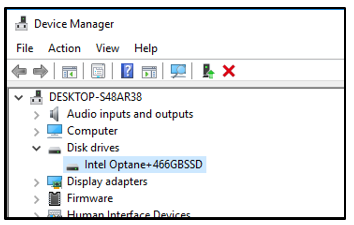

As n_scott_pearson mentioned, it is usually necessary to clear the Optane Memory module of the old data in order to use it again, but something I noticed in your system report is that Optane Memory acceleration seems to be already enabled for your HDD since it shows up as "Intel Optane+931GBHDD".
Please check Device Manager and confirm if it shows up in a similar way under Disk Drives:
- How to Determine System Acceleration is Active with Intel® Optane™ Memory: https://downloadcenter.intel.com/download/29978/Intel-Rapid-Storage-Technology-Driver-Installation-Software-with-Intel-Optane-Memory?product=35125
If this is the case, it should be up and running.
Regarding the driver you installed, the last one is indeed the latest Intel RST driver, during the installation you should be asked if you want to also install the Optane Memory and Storage Management interface, please check if this is already installed in your system, or you may install it directly from the Microsoft Store App/Website in the following link:
https://www.microsoft.com/en-us/p/intel-optane-memory-and-storage-management/9mzng5hzwz1t?activetab=pivot:overviewtab
Let me know if it is enabled, if you have other questions or if the issue persists.

Indeed, upon opening the device manager and checking the disk drive, I've confirmed Optane appears attached to the HDD, as in your example. I didn't remove the Optane accelerator from the hardware at any point, I haven't opened the laptop or meddled with its components in any way, but I had assumed it wouldn't be recognized by the system since I had to reboot forcibly. I guess/hope it should make things easier this way?
I will proceed to attempt installing the RST driver today, I'll let you know if it installs successfully or if I wind up returning to square one yet again.

I checked the device manager's disks area, and it still lists Optane with the HDD drive. I'm guessing the hardware is recognized, and the problem starts once I'm installing drivers.
