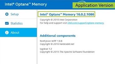

Would you mind checking what Intel RST driver version is displayed in the following locations?
1- Open Device Manager > Storage Controllers > Intel® Chipset SATA/PCIe RST Premium Controller > Driver tab
Example:
2- Open Intel Rapid Storage Technology window > Help > System Report
Example:
3- Open the Optane Interface currently installed > About
Example:
This is in order for us to check a possible version mismatch as mentioned in this article.
Please let me know the versions you see in those sections and also provide us with the Intel logs found at the following location:
C:\Users\[user_name]\Intel\Logs

The Intel Chipset Driver version is 17.7.0.1006. It matches the driver version seen in the Intel Optane Memory and Storage Management about screen. The mangement product version from the about screen is 17.8.1007.0. I don't have the Intel RST software.
It seems I also have another optane management application named "Intel Optane Memory" with less features. It looks older and the install timestamp is 2019-08-28. I think it was installed by Dell from the factory. The .exe version is 17.7.0.1006. The older management app looks to be using around 8GB of the optane memory. The new app is only using 22GB + 5.4GB of unused space. Could those 2 apps compete for optane storage as they aren't using the full 32GB?
Should the older one be removed?
