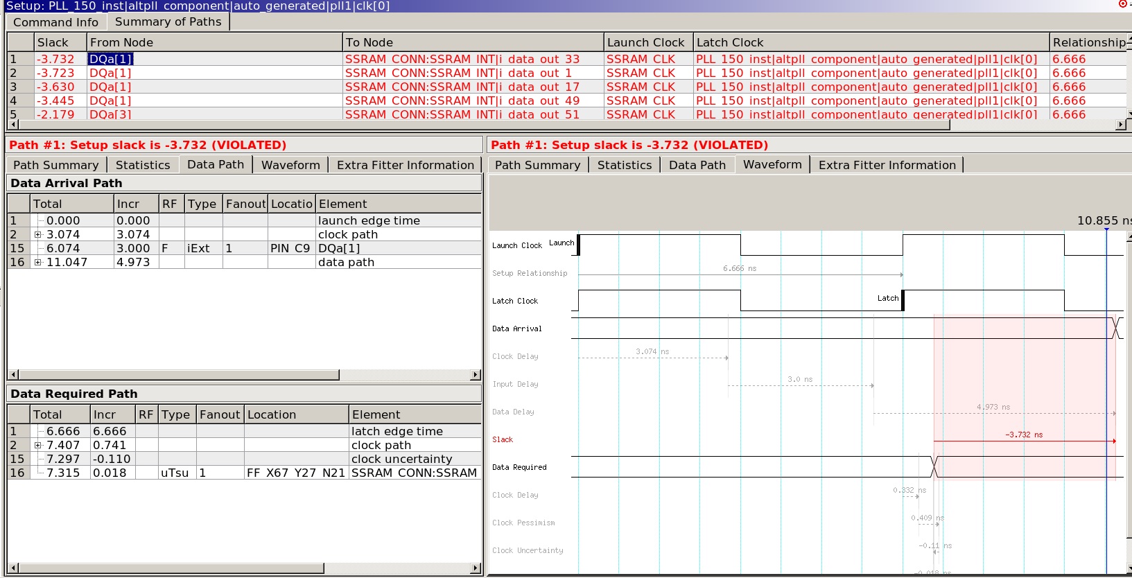

It's odd, I just rebuilt it without using the ALTDDIO (and using the same constraints I showed before), and I fail input setup by nearly 4ns. 2.4ns of that is because of the clock path (why do they become so different?). If I put the ALTDDIOs back in, using the exact same constraints (is that even valid?) I make timing. Looking at the chip planner, it does bounce all over the die. Perhaps I pass with the ALTDDIO because it forces the register near the pin? Do I need to do some floorplanning to get it sane? I haven't had to do that before, so I was hoping to avoid it. :) I've included a screenshot of the failure, for what it is worth. I was getting very frustrated with it all when I saw the AN433 document, and thought maybe the ALTDDIO would get rid of all my problems!- Mark as New
The PLL has a dedicated output, whereby its output tap can go directly out a specific port whereby it does not go through the Global clock tree. If you don't have pins assigned, it will generally use this. It's good if you're creating a clock to drive other devices since it has less jitter, but it's terrible for source-synchronous, since the clock going out has no clock tree while the data does, so they're not aligned at all. This dedicated path doesn't have DDR I/O, so once you instantiate them it then goes back to being a regular I/O.
Your setup relationship is 6.666ns. I assume the hold relationship is 0ns. If so, that means the fitter needs to add delay, approximately 3.333ns, to "center the clock". Is that what you want? Please take a look at the link I sent earlier. Basically, I would suggest either: a) Using two taps of the PLL, one to drive the clock and one for data, and phase-shift the clock one 180 degrees. This will send clock/data in a center-aligned fashion. b) Use one tap of PLL to drive clock/data. This is to send them edge-aligned. If you want to do this, I change the timing constraints to say the external device will shift the clock into the middle of the data eye.- Mark as New

By the way, I have the SSRAM_CLK assigned to a specific pin - and since I am using an Altera eval board (that has an SSRAM on it) the pin is not assigned to the dedicated PLL output. I also get the following warning, which I think confirms it: Warning: PLL "PLL_150:PLL_150_inst|altpll:altpll_component|PLL_150_altpll:auto_generated|pll1" output port clk[0] feeds output pin "SSRAM_CLK~output" via non-dedicated routing -- jitter performance depends on switching rate of other design elements. Use PLL dedicated clock outputs to ensure jitter performance So it should be using the global clock tree, so still confused as to why I get so much clock delay at times. :confused: Thanks again for your time.
