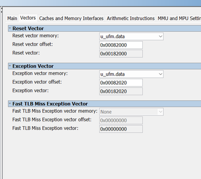

Here is how NIOS II vectors look like:

- we are reusing the reset vector offset, exception vector offset etc. as per the reference design itself. Pls see the below images for reference.

- What could be the reason for this? When the device is changed, should the reset vector offsets also need to be changed? Pls let us know how if it is to be changed.
- Should we change the other addresses which we use during BSP generation and .hex file creation as well? Let us know if it is required.

I was comparing CFM1 and CFM0 area of both devices.
CFM1 (usually application image) memory range 0x08000 - 0x49fff on 10M16 and 0x08000 - 0x63fff on 10M25
CFM0 (usually factor image) memory range 0x4a000 - 0x8bfff on 10M16 and 0x64000 - 0xbffff on 10M25
User data is placed in upper free space of each block.
