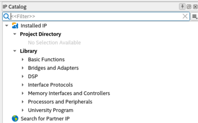

Use the IP Catalog to create an IP variant then generate an example design in that IP menu.
Make sure the Simulation is selected before you click "Generate Example Design"
