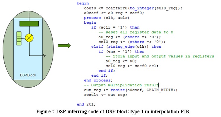

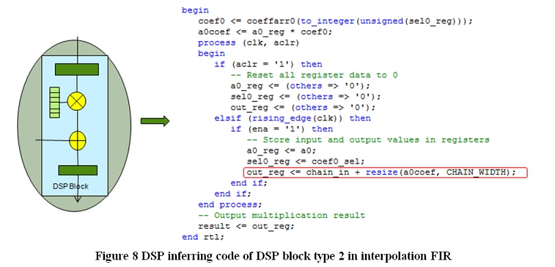

I've coded up an FIR filter in VHDL that uses up to 10 clocks to multiply sample pairs by filter coefficients and accumulate the results. This seems to work but Quartus implements this all as logic, which isn't going to fit when I need 50+ filters. Ive had a look at https://community.intel.com/t5/FPGA-Wiki/FIR-Filter-Design-in-Arria-V-Cyclone-V-DSP-Block-Using-VHDL/ta-p/735970 but I'm confused by the lack of background context that I'm supposed to know.
Does anyone have any guidance on how to use the DSP blocks as an FIR filter using sequential accumulation?

Thanks, that's pointing me in the right direction.
