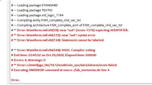

Good afternoon,
I am designing a finite state machine, I made the datapath with its respective memories and an adder. I also designed a controlpath in vhdl. But when simulating in the Waveform I have an error, apparently it is in the VHDL code.
abjoint image with the simulation error and vhdl code

RichardTanSY_Altera
1,206 Views
Sorry for idling for some time. Do you able to solve the issue or do you need further help on this?
